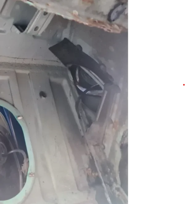

that drain is fixed to the gaiter and clips onto the side of the tank
mine came off at the gaiter end and I super glued it back on
yeah but how do you fit the tube after the tank has been fitted? the route I saw just looks weird..guess as long as it's connected it doesn't matter 😀
the tank was fitted , and when you install the gaiter the pipe seemed to locate itself , and from underneath just clipped it in to the clip on the side of the tank
thanks mate, I'll have another go next weekend!
I just did my Miss Marple bit.. and found a photo of said drain hanging out the 'ole

I found a picture of mine when I repaired it
That drain tube is quite long
That drain tube is quite long View attachment 359819
showing off your long drain =)) ... yeah I disconnected my tube from the gaiter as I didn't want to snap it off... so yesterday with just the tube tried poking through various gaps and none looked right. But it is just literally poking it where there's a gap between the tank and the body and as you say, pressing it into the clips. Now I've found the "before" photo I get it now...

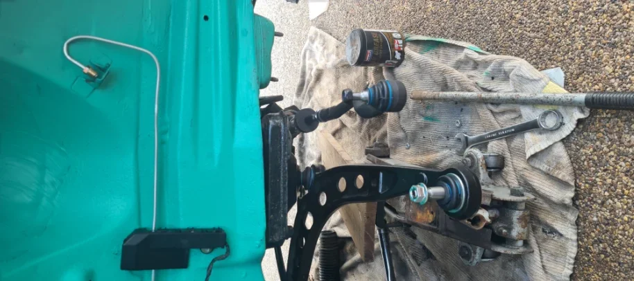

well.....this is where I've stalled. For the life of me, I cannot get the lolliops on the arms... they just pop off. I've used more silicon grease than an adult film. I've tried having it on the floor and using my bodyweight, then jammed against a cupboard. Then tried using my weight on the lollipop and lastly the vice, and there's no way it's going in.........even if I relax
I could crack on with the rest but I really want to get these on whilst there's nothing in the way..

UPDATE.... I'm in !!..... laid the lollipop on the ground, soaked it with silicone grease, pushed the wishbone in and leant on it with my bodyweight with like a sawing twisting action. Got the end level with the back hole of the bush, turned it upside down and pushed it home !!
ok bit of a frustrating first day, but.... got something done !!.... let me run than lollipop past you again...laid it on the yes a very dirty garage carpet
squirted it with silicone spray, then sprayed the end of the wishbone, and basically went for it... if you hear squeaking that means it's moving
so with brute force and ignorance I went at it
got it so the head of the post was touching the floor, turn it round and pushed down on the lollipop and it eventually "gave up" and slid down.
so that enabled me to get one lollipop on the car after about an hour wrestling with it...and there it is... SO glad I zinced those bolts

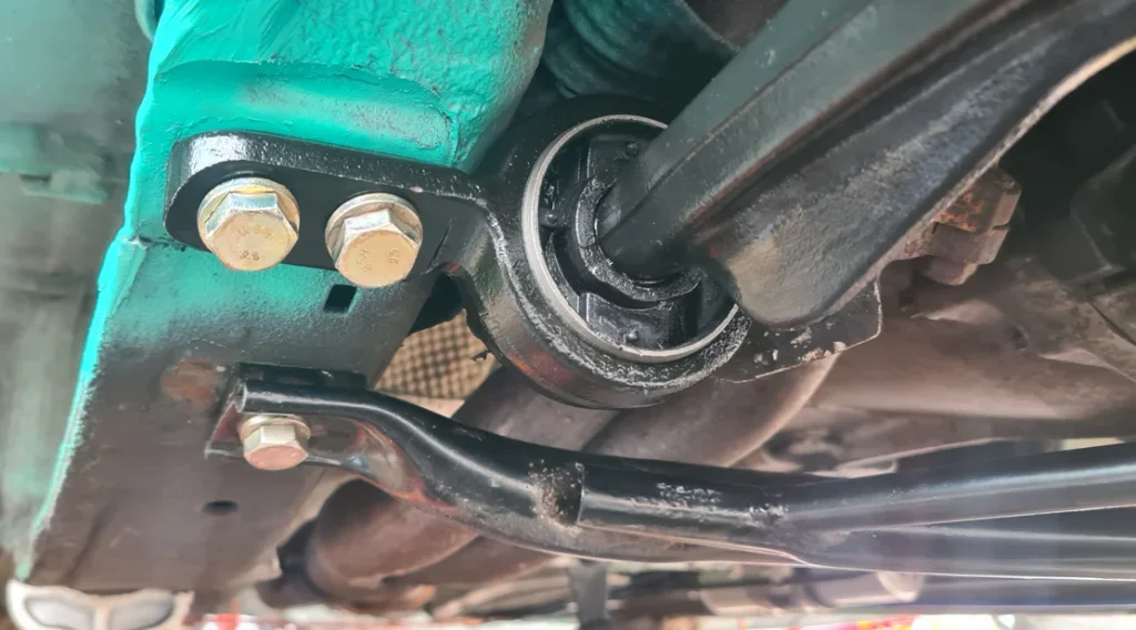

Then on with the Anti Roll bar, completely refreshed with new bushes and brackets
