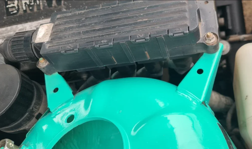

First up, top coat on the strut towers and valance..... now you could say my masking up was a bit.........pants.. =))
and again, Tristar Color paint never let me down......however, I let myself down.... forgot to cover the underneath of the coilpack...
so I'll have to take that off and clean it up
I'll let that go off for a week then a light coating of 1k lacquer...

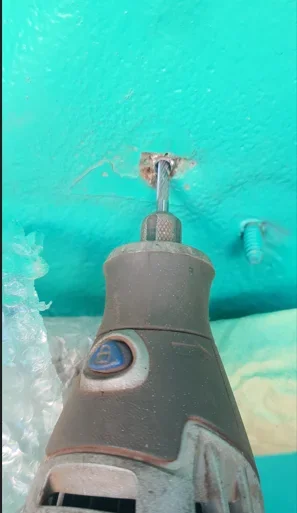

Then.... it was the turn of the connector box studs.... the sheared off studs were really fighting me and i couldn't drill through them.. ended up digging out a Dremel cobalt bit, and drilled a hole that way...
Then widened them with a 4mm drill bit.... then set about with the tap
then as per @Mazza , found an appropriate size bolt, cut the head off, cut in half and screwed in. Test fit the newly painted box.
I haven't got the plastic nuts, so I'll need to get those then spray the studs to finish it off.....
same again on the offside
Can't believe those studs took me hours....... mainly I think through blunt drill bits until I found my cobalt bit !

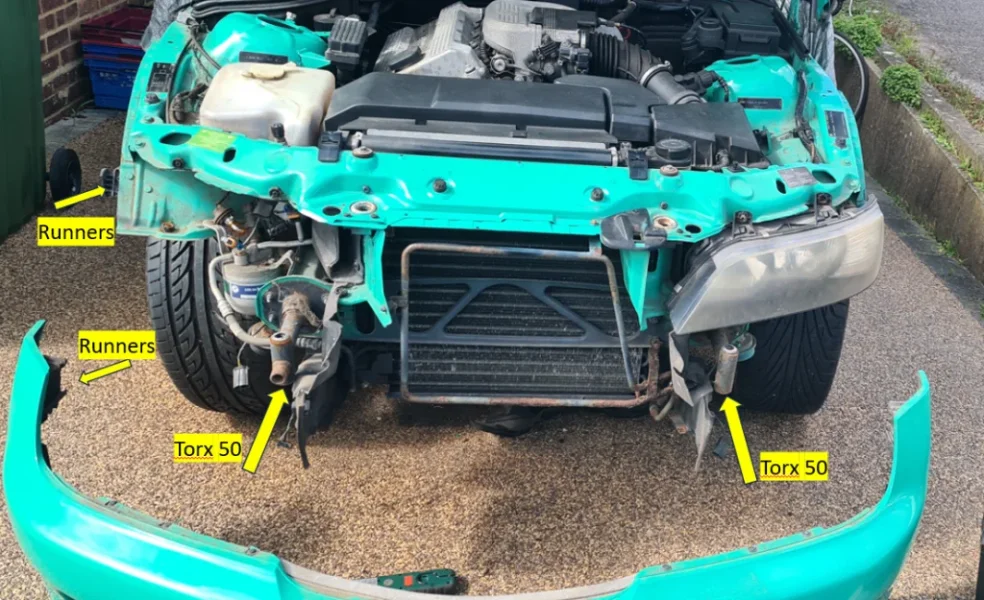

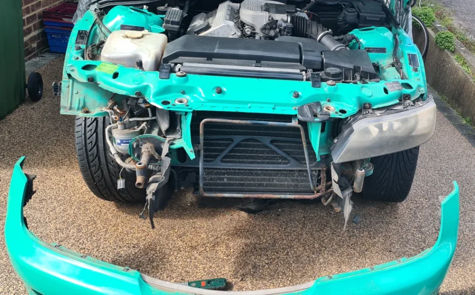

Then I decided to take the headlights off and the bumper....
Main reason for the bumper is to address this.... cracked paint..or at least lacquer
Plus it makes life much easier for when I swap over the power steering hoop
As you know it's just four M8 bolts, draw slightly toward you gives you a bit more access to the connectors...notice how crispy the indictor bulb is ? paint just peels off
eye eye... nod's as good as a wink to a blind man ! =))
now ironically I ended up having to get the bumper off in order to get to the last headlight bolt, as the adjuster was wound up at an angle... so it's literally two Torx 50 bolts and the whole thing just slides off. Either side of the bumper sits in runners, so it is literally just two bolts.
The curved bits in the crash bar are what lines up the posts. So the bolt goes through that vertical post.
Getting the bumper off gave me a clear view of that final headlight adjuster and out they both came
I'm actually thinking of leaving the bumper off, as I've got prime access to do the whole front suspension, power steering hoop and anything else I need to do under there...
The only thing to report from removing the bumper was....a cobweb
It's a good job I've got a new power steering hoop !! 😱

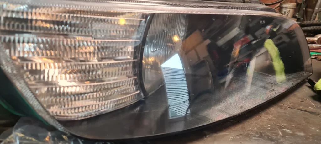

so grabbing headlight number 1 and my 3M headlight restoration kit.....it was time to be brave..
went to clean someone else's overspray off the bottom (bumper repair I reckon)
and realised the black is actually black paint !!
so I'll need to repaint that bit...
right... back to the main event... I didn't need to tape up the clips, but hey the tape comes with the kit....
Then it's on with the first pad.....500 grit on the drill attachment....and off we go !!!!
GULP !!!
Need to get it nice and uniform and yes you can actually sand out stone chips...
then it's the 800 grit pad on the drill
and you just keep going lightly over the lens until the scratched surface is nice and uniform
Then it was the turn of the 3000 grit Trizact pad... and this is to get rid of the swirls and the haze..
Although that looks a hell of lot better, we're not done yet....oh no...
This time we get to polish !!!!... polish and pad come with the kit....(the yellow stripe and white square are LED lights on the garage ceiling).....
warning... the polish will fling everywhere !!
and perhaps THE most important part...... clear coat.... or else the plastic will oxidise almost straight away....
so, comparing the before and after.... like night and day
Then it was rinse and repeat on the offside one
and just to prove I did both and didn't flip the picture ! =))
so my view?.... worth every penny of 19 quid !....the clearcoat was another 15 quid.. but for only £34 you can have these results !!

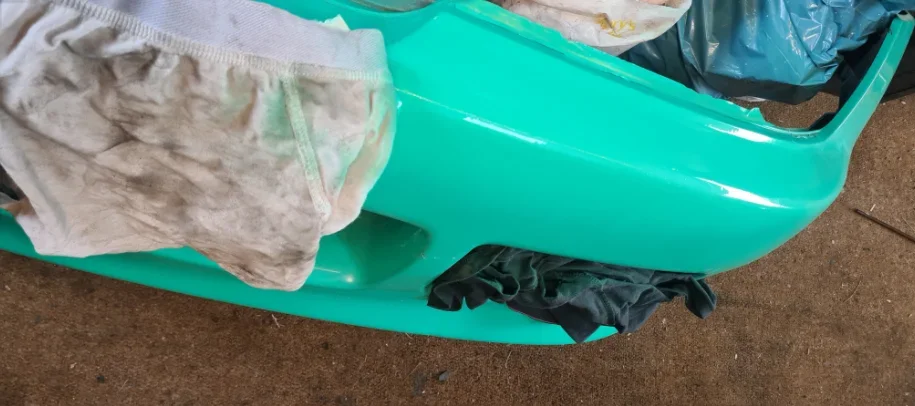

Then I turned my attention to the bumper...
As I said before either the lacquer had got contaminated or something from a previous job someone did... but it had peeled and cracked in just one area.... so I started cutting it back with a scotch pad.. then the discs from the headlight kit
more pants masking up !
Then a couple of coats of Tristar Color paint, and a couple of coats of 1K clear to finish off
yes I know.... poor girl...
