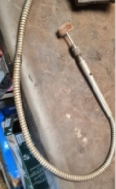

Focus today was on front Calipers.... so it was lots... and lots.... and lots... of grinding rust and other detritus off the surfaces.
used a wire pipe brush for the piston bore and the slider and bolt holes...
although it worked well, it was a little too rigid, so I then dug out my drill flexi attachment.. but, screwed it into the pillar drill instead of a hand drill, this enabled me to have both hands free..
If you use barrel sanders on a Dremel, one little tip I can offer is, don't push the sanding tube all the way down on the rubber barrel. Leave it slightly overlapping and that way, the top of the sander is more flexible and can get into more nooks and crannies..

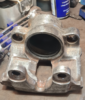

Then I thought I'd attack one of Ant's calipers.... using my socket trick, the piston just would not budge, that bad boy was in there. No matter how much I twisted, it just wouldn't budge
Then I tried something that freed it up straight away !... ok there was also liberal squirts of WD40 but.. I found if I gave the piston a tap with the extension bar and hammer, it freed it straight away... just a sharp bang on opposite sides should do it....
This is the combination of sockets I used that enabled a 1/2" extension bar to jam in tightly.. 8mm, 13mm and a shouldered 11mm, with 1/2" bar.
Then the piston started to spin....I got it out halfway and then it got stuck
.... but as I knew it was moving, I then tried the foot pump trick with a bouncy ball adaptor, few pushes and .... BANG! out it flew :party:
Then it was just endless, endless grinding with a variety of flap wheels, drums, wire wheel and stones...
gave it a good dose of brake cleaner and it's ready for paint

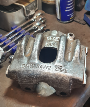

ooooooooookay.... let's try again on a NEARSIDE caliper this time eh ?
It's the one on the far left of my previous post....
apologies if I've gone over this several times but it REALLY does work for seized pistons. Tried the foot pump and no good, didn't budge... so.. here we go...
leave the bleed nipple in and screwed in.... then screw a 10mm union into the flexi hose connection...this is purely to minimise air loss. I then used a pump adaptor for a beach ball or "fitness" ball, which you have to hold and push down on.
now admittedly at first it just didn't want to budge, BUT there was no air leakage, I was actually leaning on the pump with my bodyweight.
so you know what's coming next don't you.... yep, the sockets and extension bar trick, I now have 100% success rate with this method. Turned it enough to break the seal but it still needed the piston tapping on the edges with a hammer. It started to move again so I squirted the sidewalls with WD40....quick turn and it broke free....
Then it was a case of re attaching the foot pump and out she came
Then a good clean up to get all the rust out the way, then coated in brake cleaner and dried off with the coolest heat gun ever made...
then that was it, all prepped for paint, Hammerite Silver Smooth and left to hang overnight....whole job from start to finish was 1.5 hours.

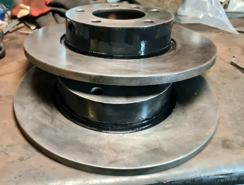

then I thought I'd clean up and paint the discs..... too much ?.... no ?.... maybe ?
1955Davidr
Zorg Guru (I)
Apr 27, 2023
86
Fylde Coast
Good call painting the non functioning part of the discs, rust around the "bell" part drives me mad, when we got the daily 3 years ago I sprayed them with Hamerite Satin black, so it was only a thin coating. This weekend I decided a refresh on the front was needed and am impressed with the longevity of the spray, proper brush job now and they have come up well. I put new discs on the back a month or so back and these parts are rusty as hell, will be done as soon as we get a good weather day this week. You can buy discs with a coating that is supposed to stop this but in my experience it is a waste of money and only lasts a month or so.
