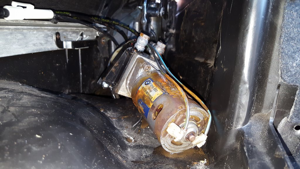

The motor was soaked and rusty,
and the bottom housing was full of the dirtiest water imaginable, that could run down my face as I tipped it up in the boot over myself.....!
With the motor pulled into the boot you can see the ram and associated hoses to it, Try not to pull too hard on these:

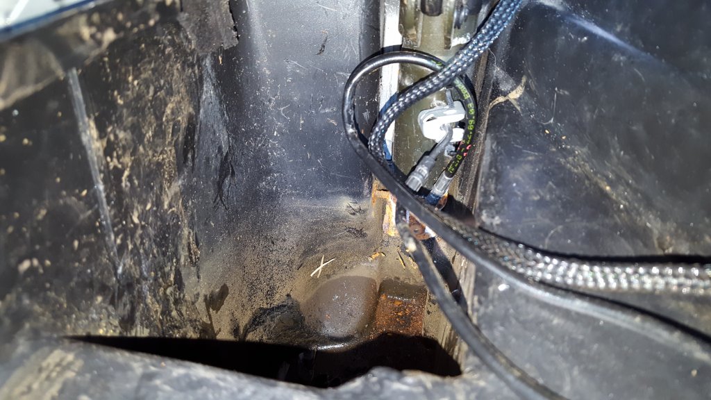

Now you can see (with a camera) the bottom of the plastic well and the drain hole. Note the rusty water tide mark:

You can separate the motor from the pump by removing 2 allen bolts, but do this with the pump downwards and break the joint nearest the motor or you will lose hydraulic oil (ask me how I know)
With a quick wipe down and wire brush, I then sprayed WD40 all over it and inside it. then connected to a 12v power supply and it immediately came back to life so I ran it in both directions whilst still oiling it.
Sorry no pictures for that.
After putting it back together and topping up with hydraulic jack oil through the little plug in the top of the pump. (check level with roof down) I was able to get the roof up and down fully with no noises,

Thanks for taking the time to not only report on how you did this, but to also take excellent instructive pictures. I am stuck,.....I have the motor and pump assembly lifted out of the bucket,......but it is being held in place by something,....I believe it is the hydraulic lines,....they appear to go back down into the bucket and disappear somewhere,......preventing the motor/pump assembly from being pulled into the boot area.
Suggestions?
Brian
Not sure what it could be, but, it isn't the hydraulic lines. It has to be something else.

The lines do indeed go under the bucket and the bucket needs to be lifted upwards bringing the lines up with bucket so they can be unclipped from the guides moulded in the bucket base. The tie wrap holding the bucket in there needs to be cut or broken so the bucket can be lifted out.

Got it out,….heres how. I happened to catch a post referencing removing the rubber at convertible top hinge point on the passenger/left side of the car and using a long knife or in my case a long prybar, breaking the plastic bucket attachment away. Get a good flashlight/torch and look in there and you’ll see where the bucket is attached. With some serious prying with a
24 inch prybar I was able to break that attachment and then got back in the trunk and was able to now lift the pump assembly further up and then reach further back in and grab the bucket and pull it up as well. Once the bucket was out of the well area, I could see where the zip tie/tie wrap secured the bucket to the hydraulic lines and was able to reach back in with a sharp knife and cut that now I could pull the pump into the trunk and completely remove the bucket assembly.
