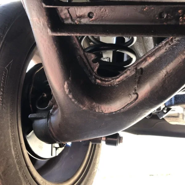

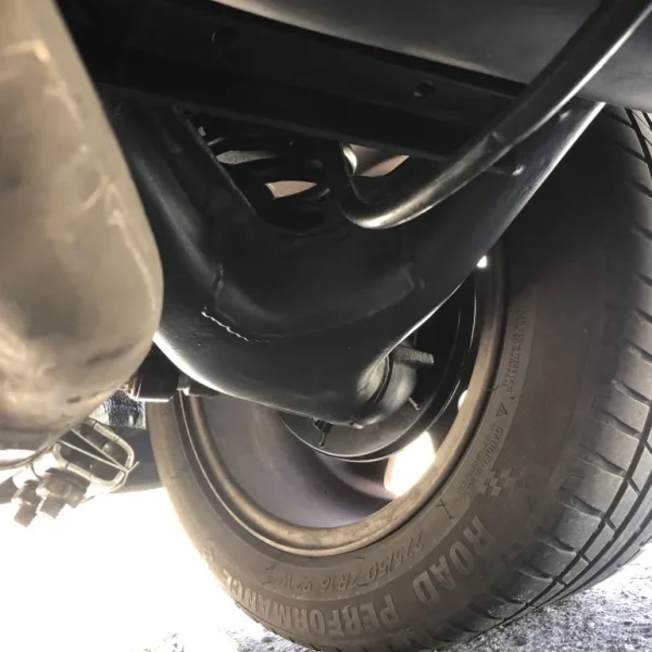

My wife’s had rotted here , re plated and filled back up with wax

That’s a real nice job. Wish we had someone who would do that for us.
