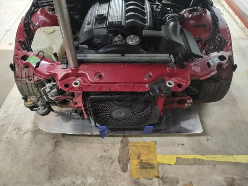

Here I started fitting an aluminum under tray. Made some brackets up and a bit more CAD work to do. That's cardboard aided design for those that were curious. I still have a ways to go for that yet.
Looking good, I used ABS sheet, a wall paper stipper heat gun, some Milliput, painted steel strips, rivets and bolts.

Thank you Pingu! I've definitely watched that video before and have been using it to draw ideas from. I really like the 'cat whisker' idea and have ordered some plastic sheets to start making my own wheel arches.

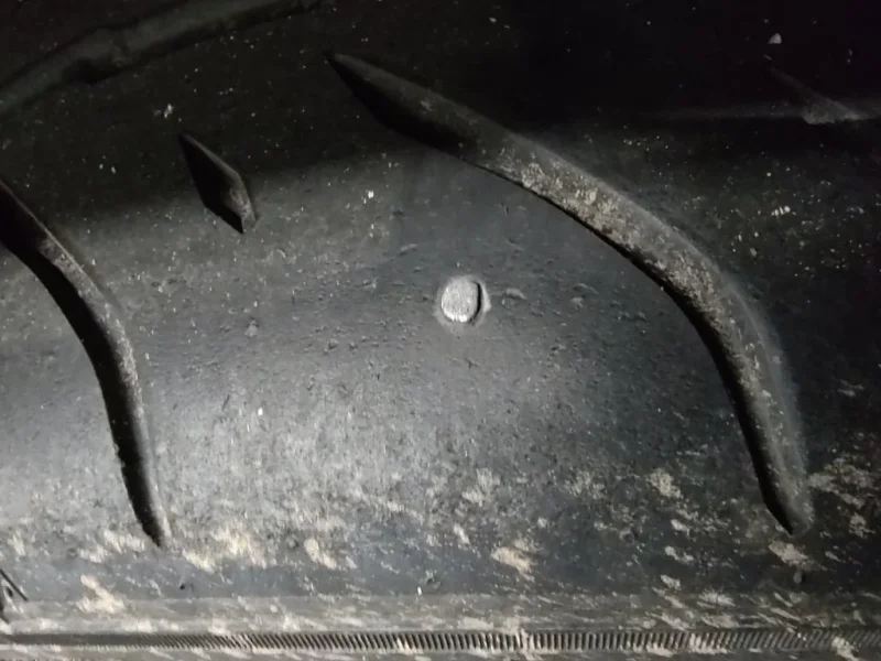

Adding the extra width to the tires not only looks great, but the car handles very good now...and I haven't even aligned it yet! These are also a vast improvement over the previous rubber. A 10 year old ok-ish summer tire (Something like 400treadwear?) with some Azenis RT660 (200 treadwear). A summer car deserves summer shoes.
Annnd of course I picked up a nail within 200 miles. :( I'll plug it and hope for the best.

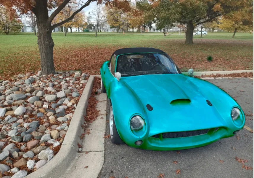

I have been traveling for a while over the past few weeks so I decided to play with some photo editing to play with colors :) So I'll leave you with some fun colors.

FYI I have the same lights and mountings on my Z300S. Work a treat, though I am going to get them stripped and powder coated. They are not holding up well to the British weather!
Oh sorry to hear that! The ones I have are supposedly stainless steel, but time will tell. Your car is coming along! Keep it up, seeing other people makes progress gives me motivation to keep working.
