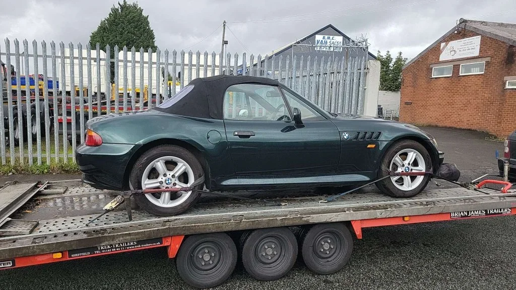

I took our two other cars (soon to be one) into the garage for MOTs the other day and the owner Jimmy told me I left another puddle of ATF behind at the last attempt. I think the motor itself is leaking, so that needs addressing before the next attempt. As well as redoing the layout of the motor cooling system to make it more accessible.
If I can get away with not modifying the adaptor plate this time, I will. I had planned to trim it down a bit and clean it up. If I have to take the gearbox out then I might still do this. But actually I think I might be better just making a new one and swapping them out once the car is running. With everything I know now I could make it much lighter and neater.
But the main thing now is to get this car on the road. Some changes in the kids’ weekend activities means that now we unexpectedly need two cars again, just as I have found a buyer for my Alfa. This means it might be challenging to do the body swap as planned this winter, unless I can take a week off and get the car stripped and road legal again in that time.
