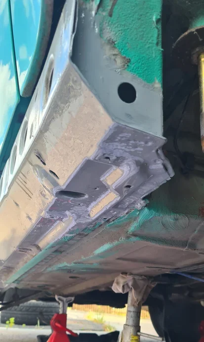

Then it was a liberal coat of POR15 Metal Prep. You have to keep it wet for 20 minutes, then wash off, then dry thoroughly for which I used a heat gun.
Then it was a good coating of POR15 Direct To Metal on the front and rear of the sill
and yes I did get rid of that drip bottom left... :whistle::whistle:... this will dry shiny and rock hard. After that you can key it with a scotch pad and then apply Epoxy Primer and top coat.

Excellent job..I know where I am coming when I need mine doing 😁
thanks mate, I've had mixed experiences with POR15. I had to take it off the offside sill as surface rust came back. My only theory is that I didn't stir it enough, as I remember it being really watery. This time I made sure it was thoroughly stirred and all one uniform colour. It did feel thicker this time and went on much smoother. Hopefully that'll do the trick
Good to see that you're not trying to grind out the rust pitted areas. I see too mamy people.going at it with an angle grinder till it's super smooth where it looks good but hardly any thickness left.
You're doing a good job. Better than I would. I'm too lazy. I just brush off the loose rust and treat with oily stuff. 🤷‍♂️
thanks mate...yeah this is as far as I'm going with the rust treatment. Then it's epoxy primer and paint. Need to get the car off the jacks soon as come next month it's been on jacks for a (gulp) year !
