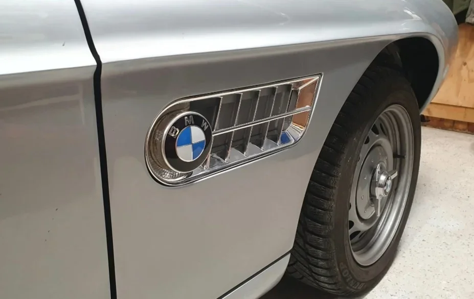

Currently playing with the VW hub caps to get that 50's 60's "Rudge" look. Have you seen the price of replica rudge wheels?
I don't think I'll do the faux spinners though. Looking at the big knockon hex centre nut idea instead. This is just a stuck on boot badge to cover the VW logo to see what it looks like. Hex nuts on order. I'll post another photo once it's all body colour with the hex nut. I like it though. Looks kinda correct.
This is the style I'm using for inspiration. (Except majority of 507 wheels were body color not chrome)

The tyre is just a test to see if it would fit. Profile is way too high. It's 205/70x16 on a 7J wheel. I also have a pair of 6.5J16 wheels with 195/65. I think they will be the ones I go for but still thinking.
You filled the small holes as well...nice. I like the spinners but may change mine for the 2 spinner style as I tweak 😎
