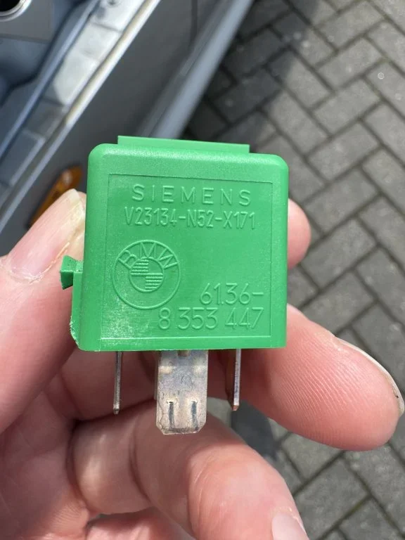

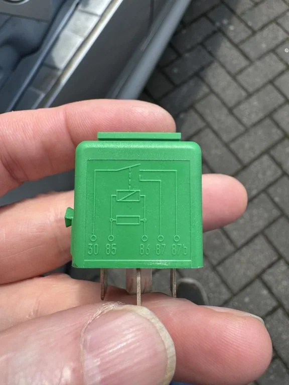

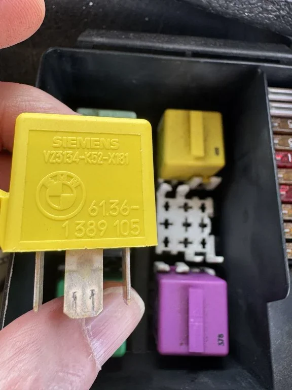

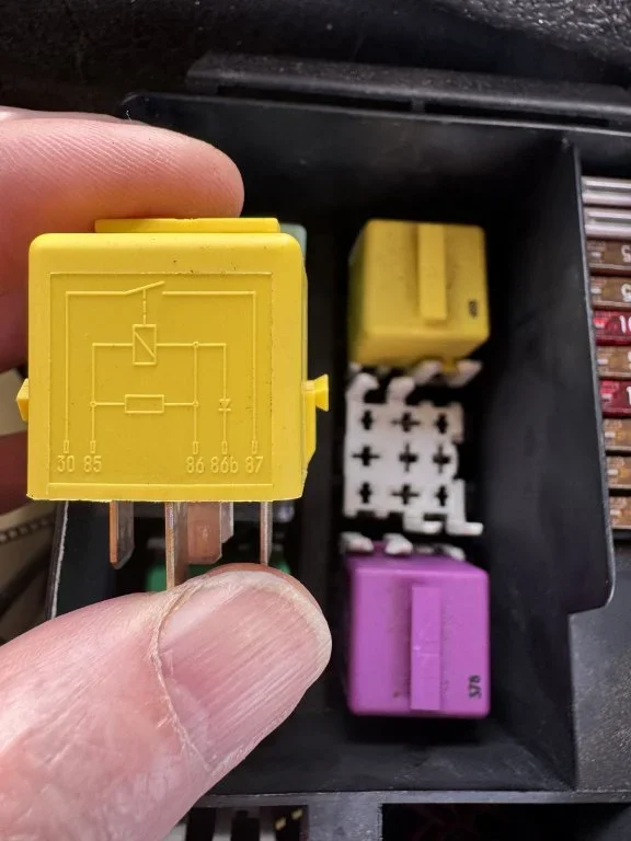

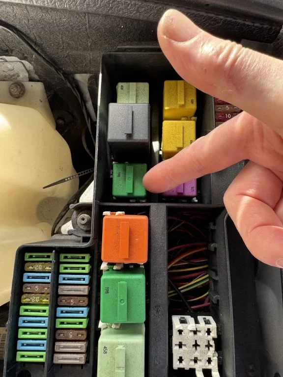

Could you look at the BMW part number on the high speed relay and photograph the schematic on its side. It is the third from the rear of the car in the nearest row to the offside in the main fuse box inside the engine bay. It’s easily removed with a pair of pliers lifting vertically.
March 1999 cars were a hybrid crossover rare car so it would be useful to know the exact relay used in a car that is the same period and has working slow speed Aircon fan.
Many thanks in advance

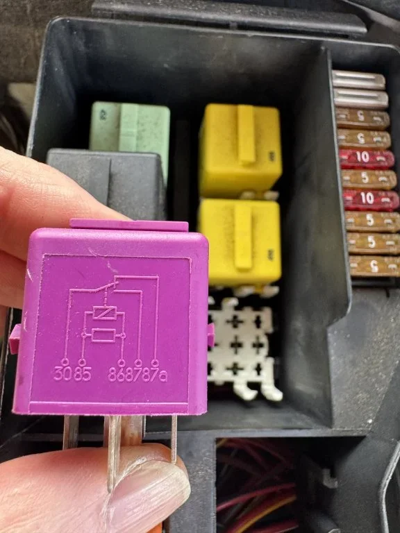

I hope this helps.

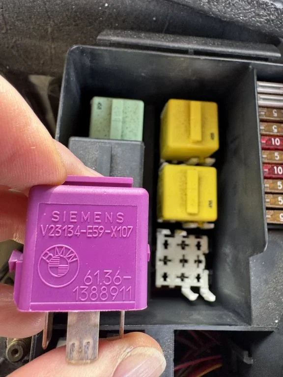

Sorry, no: But you photo is very useful by colour code! it’s the purple one directly below your finger.
My guess it ends 911? That is the Fast fan relay.

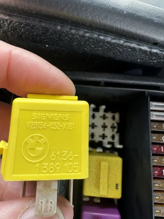

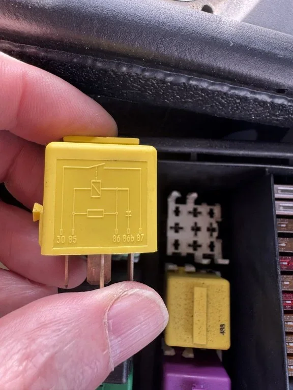

Could you look at the two Yellow ones on the right of the Purple one - Hopefully the schematics show an internal diode in the earth on the extreme right relay - not sure about the central yellow one?
I'll try again MickyG.

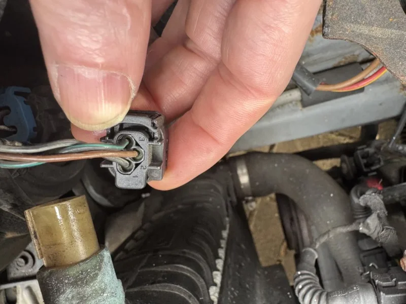

See if these pics help, also the comment from Althulas about the radiator temp sensor plug there is a bit of information online about some Z3's for whatever reason having the plugs wired differently mine most definitely has the brown wire on the central pin.

TiggR_R1 - Thank you very much for these photos they are very useful: they have not solved my problem 😂, but put me in a much better position to solve it.
I had naively transferred the relays from my facelift donor to my prefacelift Z3 expecting them to work 🥴.
I have now inserted relays matching your description/photos, and which now correspond to the BMW schematic diagrams for a late 1998 yo March 1999 Z3.
Electrical circuits are not my strong point, though I can follow it in principle and run basic voltage and continuity tests.
Althulas’s comment regarding the incorrect wiring is something I had read and was able to set aside as my plug is the same as you show (photo again useful).
So, now all the pointers are to either the Aircon controller or wires leading to and from it.
Now that zi know I have the correct relays in place my testing becomes meaningful.
(Previously with the wrong relays it was a case of “Rubbish in: Rubbish out!”)

Mike might this possibly apply to you with the green and brown wires on the fan being wired incorrectly from the factory?
View: https://www.reddit.com/r/bmwz3/comments/1j1318o/tracking_down_ac_issue/
Hi Althulas - Thank you for your research: I had seen this - apparently it was due to a translation error (German design - American built!).

Reconfiguring my relays to match those shown in TriggR_R1’s photos I now have a different set of outcomes!
Nothing works!!! 😳😂😤
The compressor does not come on now in sympathy with the slow fan that does not start.
This is not necessarily a bad thing as testing has shown they both work when an earth is jumped to their respective relays.
This now has a consistent logic, pointing significantly to the condenser controller or DME (ECU), as they both have transistors that, given the correct inputs, should switch to earth to trigger the relays.

I have a suspicion that my pins 85 and 86 in the base are the wrong way around and the relay is designed to only work with current flowing in one direction.
