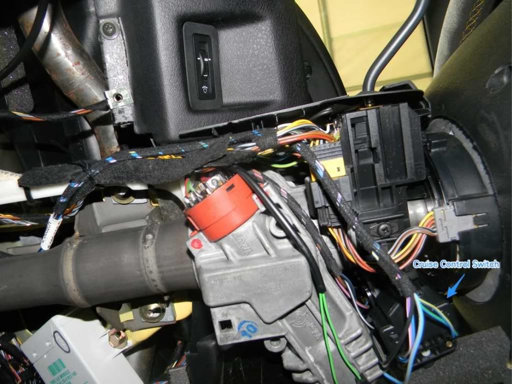

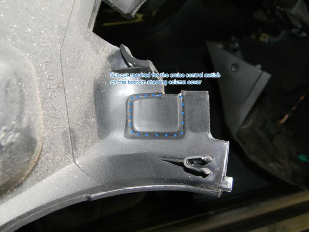

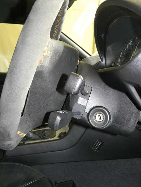

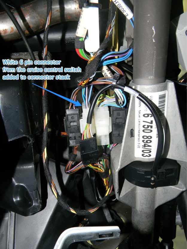

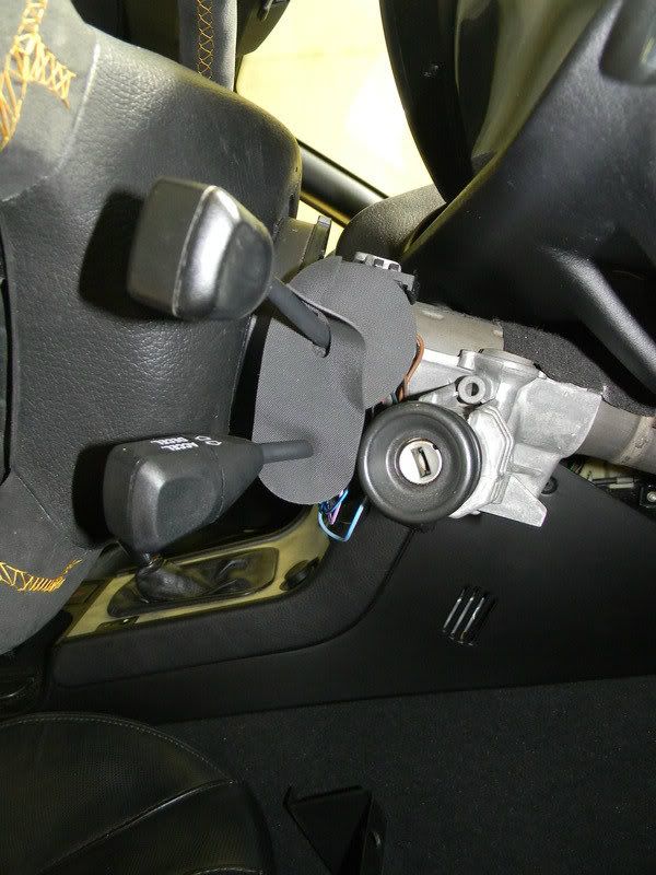

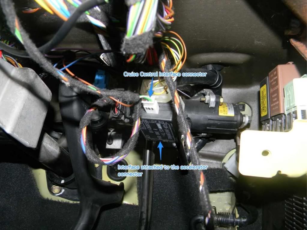

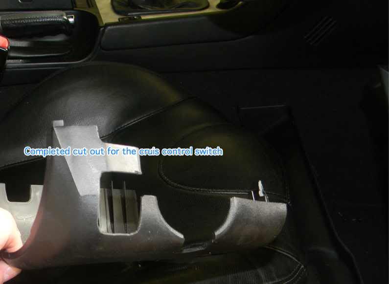

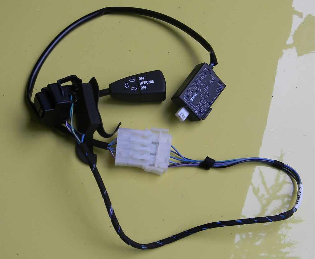

After reading various posts regarding the retrofit of cruise control to the various models of Zeds I decided to give cruise control a go on my car.
My car is a 2002 M54 3.0i build date nov 2001 with a fly by wire throttle. As far as I am aware this guide is applicable to all fly by wire throttle...
