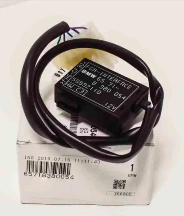

The telematics module buy from Bmw they are around 40 quid cheaper than Ebay last i checked.

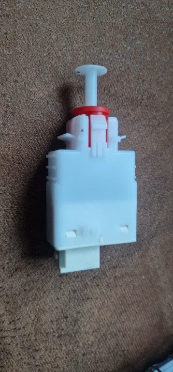

Clutch switch for manual gearbox is available generic so about 12 quid

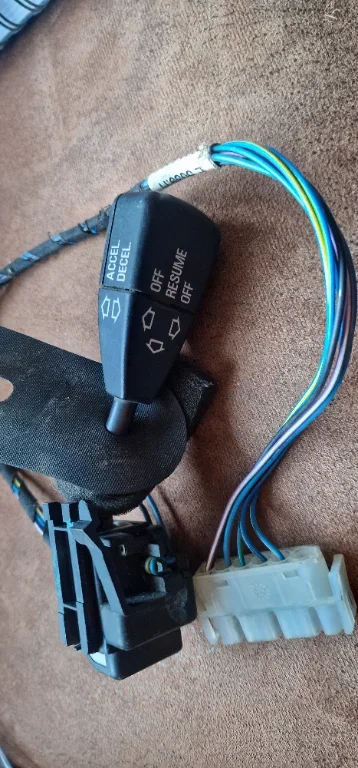

1x cruise control stalk
1x clutch switch
1 x telematics module
I'm certain that I didn't fit a clutch switch to my manual 2.2i M54 Reg. June 2002. It works perfectly.
Done mine many years ago, M52 TU with cable throttle but has ASC so has electronic throttle control. Didn’t need a clutch switch it was already there.
