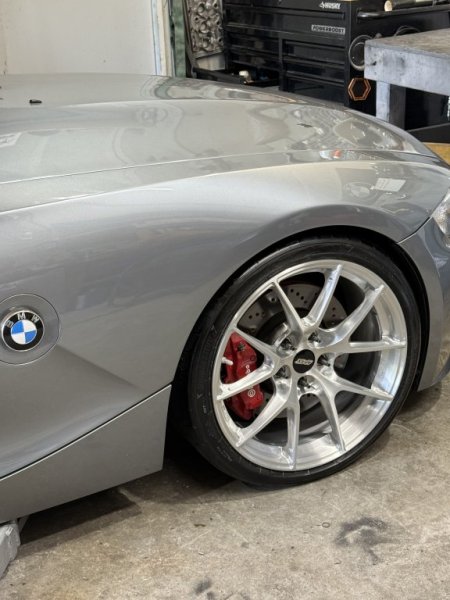

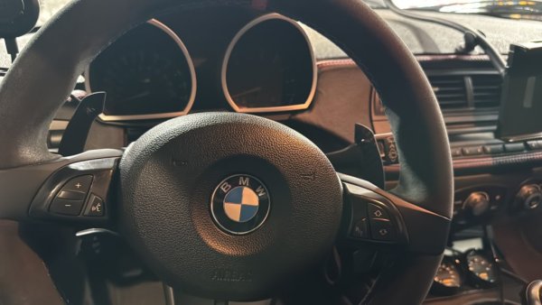

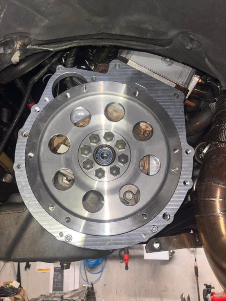

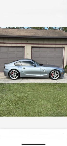

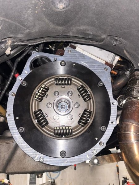

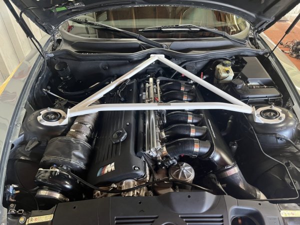

Nelson here from Florida,2006 Z4M Turbo with F80 dct

Making 470 at 9psi,engine and DCT gen2 controlled by Maxxecu Race with PnP jumper box so not cutting of stock harness.Boostline rods with JE pistons,ARP mains and arp head studs paired with Athena cut-ring gasket,flex fuel 1200 injectors.Apex 19” vs-5rs wheels,Brembo 996 Porsche calipers with Rally Road adapters.Skyer Carbon Fiber roof and rear wing,car is currently getting painted.I know I forgot some other things but that’s the majority.

Currently I am running a SM420 six speed from an M3 and been looking at doing the 8HP swap instead. What controller are you using and what did you do for a gear indicator? I have seen a few people with small screens but not really found any details.

Turbolamik,I’m looking to upgrade the indicator also to a larger one.Seemslegit has a good one for sale.
