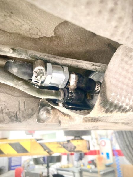

3. As mentioned above, I’ve become fed up accessibg the fuel pump/gauge - so as I was already into the fuel line - inserted the one way valve ($5) before the fuel filter. There was room - needed to add a bit of 6mm id pipe.
Pic attached.
I hope this sorts it out. The issue was erratic so I’ll only know on a few weeks.

Ok - first 24 hours was erratic - but seems to have settled down.
