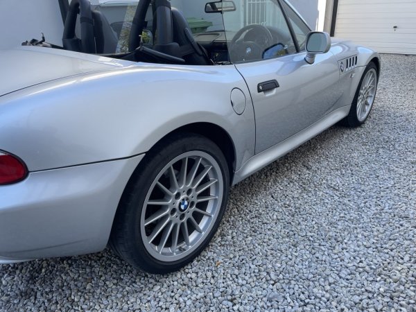

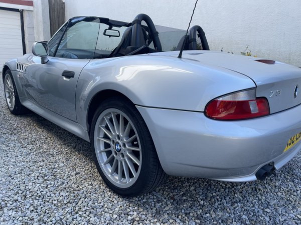

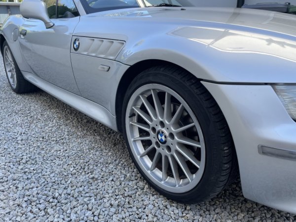

I’ve been considering the same question. My Z3 is a 2001 2.2 non sport version on standard suspension and a low mileage car (37,000 miles).
Changed from 16” wheels to style 32 18’s when a set became available with tyres. I was concerned regarding possible harsh ride, tramlining etc.
Fitted The wheels and adjusted tyre pressures to 30 psi all round. I’ve had no isssues whatsoever with a harsh ride, tramlining, vibration etc. Driven on a variety of roads. 18’s certainly look the part and very happy with the change.
Just my experience and opinion, obviously the set up and condition of suspension and steering systems will have an impact.

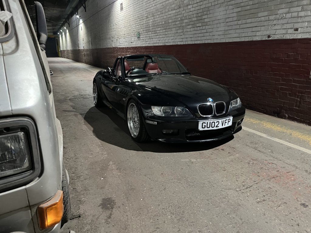

Wheels arrived earlier this week - had the chance to fit them after work.
Thankfully, they don't look too big (in my opinion) - think the lowering and smaller tyre profiles help with that.
I went with ET35 in the end as I was advised 42 may not be the best fit - turned out to be very good advice, although I added 15mm spacers on the rears.
