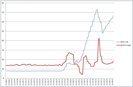

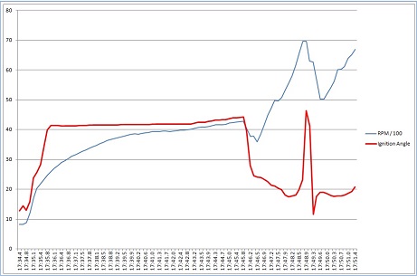

I agree, my 66 mustang has a machanical ignition and comes on like a. Bear at anytime compared to an electronic. Also putting 271HP from a 289cu in v8. Latke slow off the line being an auto but comes to life from 200-7500 rpm! JIMIgnition Angle
6.4
5.2

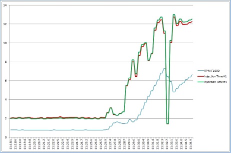

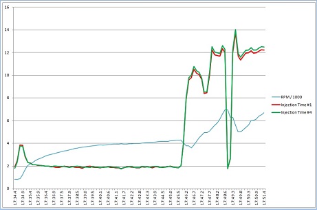

The ECU does not know what you are going to do. It only knows what you have done. Consequently, the timing of the next spark is based on what has just happened a few milliseconds earlier. If you set the revs to 4000rpm, the ignition is fully advanced and ready for action. If you gun it from idle, the timing of the spark needs to advance - this takes time (as you can see on the 6.4 curve).
Mechanically, there are no gains to be made, but if it were a mechanical distributor, you would want the ignition to be held against the spring, so the force to move the points would be acting in your favour. As far as I am aware, electronic ignition with no moving parts just happens. The only way to improve it would be a remap.
