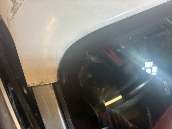

I'm trying to build a SWB GTO Tribute kit on my 1999 2.8 Auto Z3.
The first parts of the kit I fitted I fitted were the parcel shelf and the boot extension.
I 've arrived at the point where I'm fixing the rear body and I have an issue with the roof and the windscreen.
The roof fits beautifully but it covers the windscreen seal and I can't see how once fitted, the windscreen could ever be replaced.
Chris at Tribute insists that the panel needs to push down at the back and this will draw the roof back.
The panel fits at the door shut and it can't go down or back at that point.
Has anybody else had this issue?

Maybe it needs to move back just a fraction and see-saw backwards a bit just to clear the windscreen surround.

Hi
I'll take another look. The rebody threads I have seen are convertibles.
Please see picture.
The body panel needs to go back 12mm

Your picture. The roof line is way to far forward.
Ignore the back for a moment. Concentrate on the front roof line. Get that lined up. Now go look at the back. Show us what the back looks like over door B pillar.
Looks about the same as in @mittaw s pictures which you linked before he cut it all back.
Seems to me that Tribute can't make a decent fitting kit. Not good IMO, especially as ALL Z3s are the same dimensions.
I was looking at the roof on mine earlier (still has the Z3 convertible top) and it would have made sense to me for them to have moulded the roof to sit in the channel that holds the soft top, then bonded in. That would give a flush roof line for the GRP to windscreen surround.
Even if the OP can get it to sit behind the windscreen surround, it is going to sit proud, which will look like a dog's dinner and be 'whistley'.
Or have I got it wrong?
