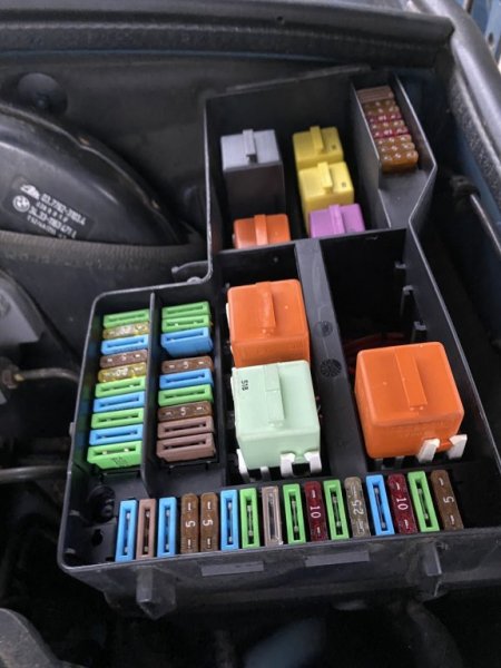

Two very minor issues which appear to be power related however in both cases the fuses appear to be fine.

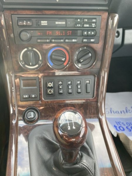

1. On Board Computer is blank. The previous owner recalls it to be operational.
2. The side view mirrors to not appear to work via the switch in the drivers door.

Aside from fuses is there anything else I should be checking as the root of the problem. A common cause?

I replaced my interior with one from a Z3M, no OBC, I did not care, I'm needing AC since I live next door to the surface of the sun in Phoenix & the clutch is not engaging. I saw it wanted ambient and since I removed the OBC thought that may be connected so I reconnected it and it is blank.
It is 97 right now & has not been under 70 for some time, is that still a possibility (that it needs time to "readjust" I checked the fuses they are fine & it was working before it came out.
I also have odd outside mirror issues, sometimes they don't work with the door closed. I have replaced the switch & the same sporadic issue occurs, they work all the time with the driver door open.
I just sprayed contact cleaner into both sides, it lights up from the headlight switch. Nothing else though.
