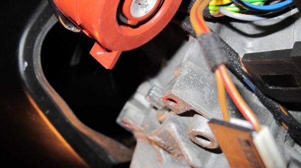

Further to Tony's comment I have had a spinning lock a few times over the years - sometimes with engine running . I have managed to reset the barrel by removing the electrical switch (2 small screws only) and then turning the spindle with the key in the lock. see pics switch is orangey red part.
