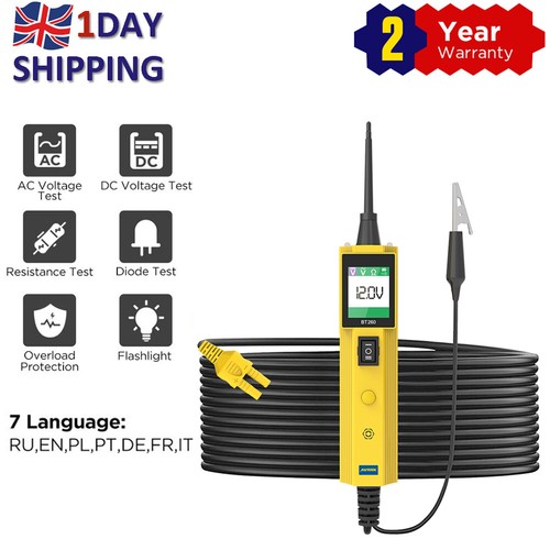

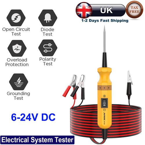

I would disconnect the wiring from the blower motor and use a power probe to give it a live feed to see if it will run. A basic power probe is fairly inexpensive these days. When I got mine from Snap-On Tools many years ago they were around £100.
If you can afford to wait a bit you can get the same item direct from China for £16.99.
Here is how to use one , if you didn't know.
