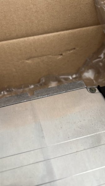

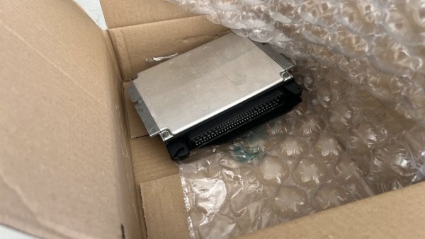

DO NOT USE COMPANY CALLED ECU TESTING (.com) SERVICES ..
Sent it away with extra protection , as there site mentions “must be package as will not except any responsibility if not packaged properly no oil inside etc..”
Great web site , kept me updated throughout very impressed to be honest.
Unfortunately had a phone call saying they couldn’t repair as there set up not compatible with my ecu..
They sent it back in a box with “no protection whatsoever” , rattling around this super rare fragile part!!
The inside of the box was badly marked , actually denting the sides of the cardboard box where the ecu was hitting the sides , fortunately the ecu wasn’t damaged , such a let down!!
Pics showing how I sent it too them and well the pics tell a story!!
