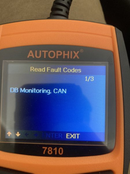

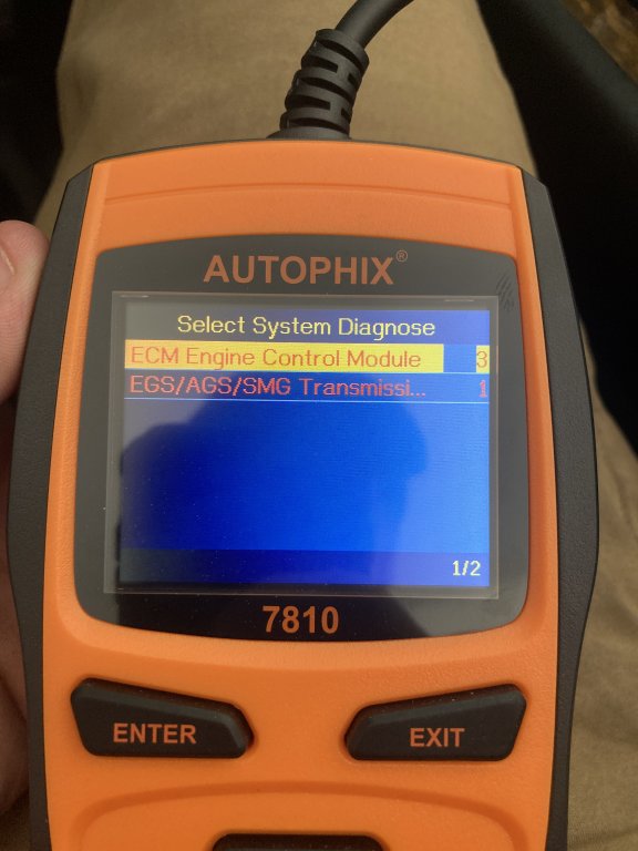

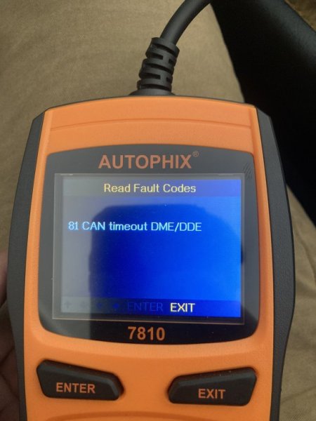

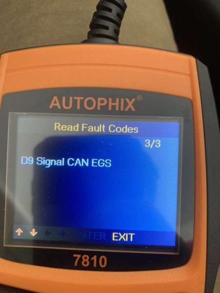

Did you get the wiring diagrams? This is where you needed them to see what fuses power the EGS.
yes I got the diagrams,are these the right ones ? It says fuse 26 is the egs and it’s supposed to be a 10a, i double checked the fuse even replaced it with a brand new fuse. Still no change. What’s next?

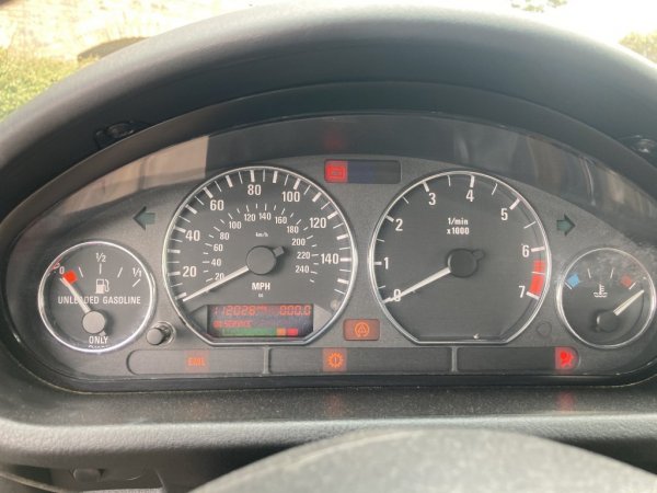

Unplugging the MAF causes the engine to run around -3% rich. This can mask lean conditions and the car runs better. What are your 4 fuel trims at hot idle with the MAF plugged in?
With the MAF plugged in, do you have the "Cog of Death" warning light up?

the “cog of death” is on yes
