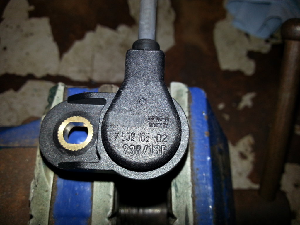

Try Euro Car Parts but stress that you want OEM quality. I got one for my Z3 from them and it was a Genuine Bosch part with their company logo ground off. The part no. was still there and when I Googled it, it came back to a Bosch part.

This is the one I purchased with the Bosch Logo removed but still has the part number on it 7 539 165 - 02 and made in Germany. Try Googling the number.
This the non-descript item I originally got from them (cheap crap) which lasted only a few weeks.

That's a great heads up from Tony. This is a part that commonly fails, 3rd party sensors are generally useless and OEM are indeed hugely expensive.
The part number 7539165 is the BMW part number. OE part suppliers will sell their own branded versions of BMW parts (well it's their product anyway at the end of the day) but not usually with the BMW part number on it. So I believe this is a BMW part with the BMW legend scrubbed out. This is the BMW part.
So it looks like Bosch has dumped some overrun stock on the market - possibly as a one-off. Of slightly more concern would be if they had failed BMW QC but passed a lower Bosch QC. I doubt it but I know this happens in the world of PC components.
If it was half the price of the BMW part I would happily buy it without giving it a second thought.
But one last thing before you rush out. Tony's part is specifically for a 6 cylinder M54. You have a 4 cylinder M44 which requires a different sensor. I believe the part number for that is likely to be 1743072.
You can get the 4 cylinder as a Meyle part for £30 on eBay. Meyle have a great reputation for eg suspension components but whether that extends to sensors I don't know.
Personally I'd prioritise a secondhand BMW part over a cheap copy part. But I would be tempted to try the Meyle part at £30.
