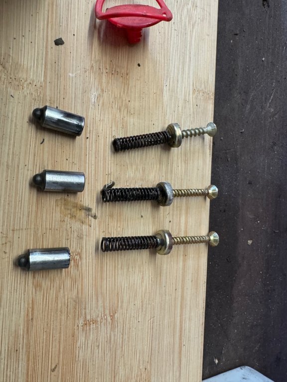

Really rattling through the jobs on this car. First job today was the gearbox shift pins. Very common finding 1st - 2nd very notchy and this solves it every time.
First pin going in with new head and spring
Moving on
full house. All old pins extracted.
ready to go back in.

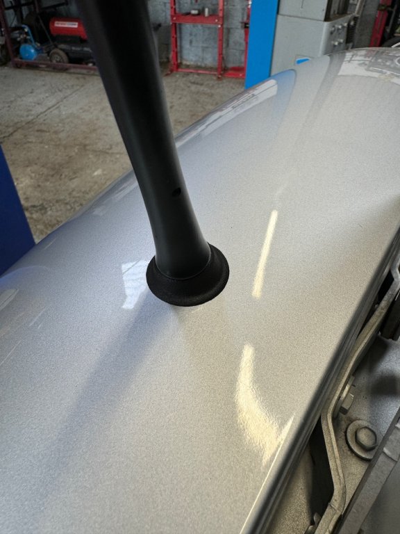

Did some of the final jobs today. Got the lollipop bushes fitted that took some going fitting them while the wishbones were already fitted, also did the diff oil change, Ariel grommet was fitted. Also finished off just doing the cruise control retrofit.
Wishbone bushes changed
Ariel now replaced and water tight

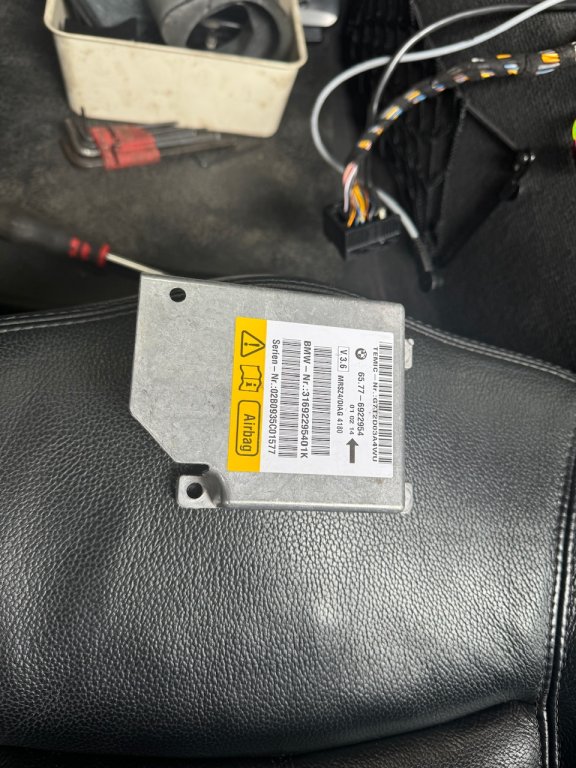

The plot thickens with Adriens Airbag fault. Diagnostics pointed towards the main Airbag control module being at fault, this needed us to remove the centre console to inspect it only to find it was the incorrect module for a Z3, so someone had been here previous trying to sort the issue.
Once we fitted a Z3 airbag module and set it up the fault pointed towards the passenger seat occupancy sensor. Looping it out showed the fault clear so a part has been ordered, fingers crossed this is the end of the airbag light as it’s been on for some time.
Looking closer you can now see it says V2.5 and now Z3. Before it stated V3.6 and Z4. Assuming the newer module uses the wrong coding to operate the system.
Every day is a school day when it comes to electronics for me.
Incorrect module removed. Notice V 3.6 & Z4

So to close this build thread out. The airbag issue continued for a number of weeks, after we replaced the module we could then interrogate the system and see a passenger occupency issue. But no matter how many emulators I tried it would never clear. In the end I had to call our auto electrician to work his magic, this took some serious time to pin him down, after a few weeks I managed to get him over and he confirmed the original unit to be dead (likely a broken soldered joint) he then had to alter to code to make the light clear and bring the system back online. He muttered some other stuff which I didn’t have a clue about. =((

Did changing the pins make for a smoother gear change?...mines still a bugger sometimes getting into 1st.
Lee
Mar 26, 2014
193
Basingstoke
Z4 Coupe 3.0si
Yeah common thing we do to all ZF boxes that have notchy gear changes.
